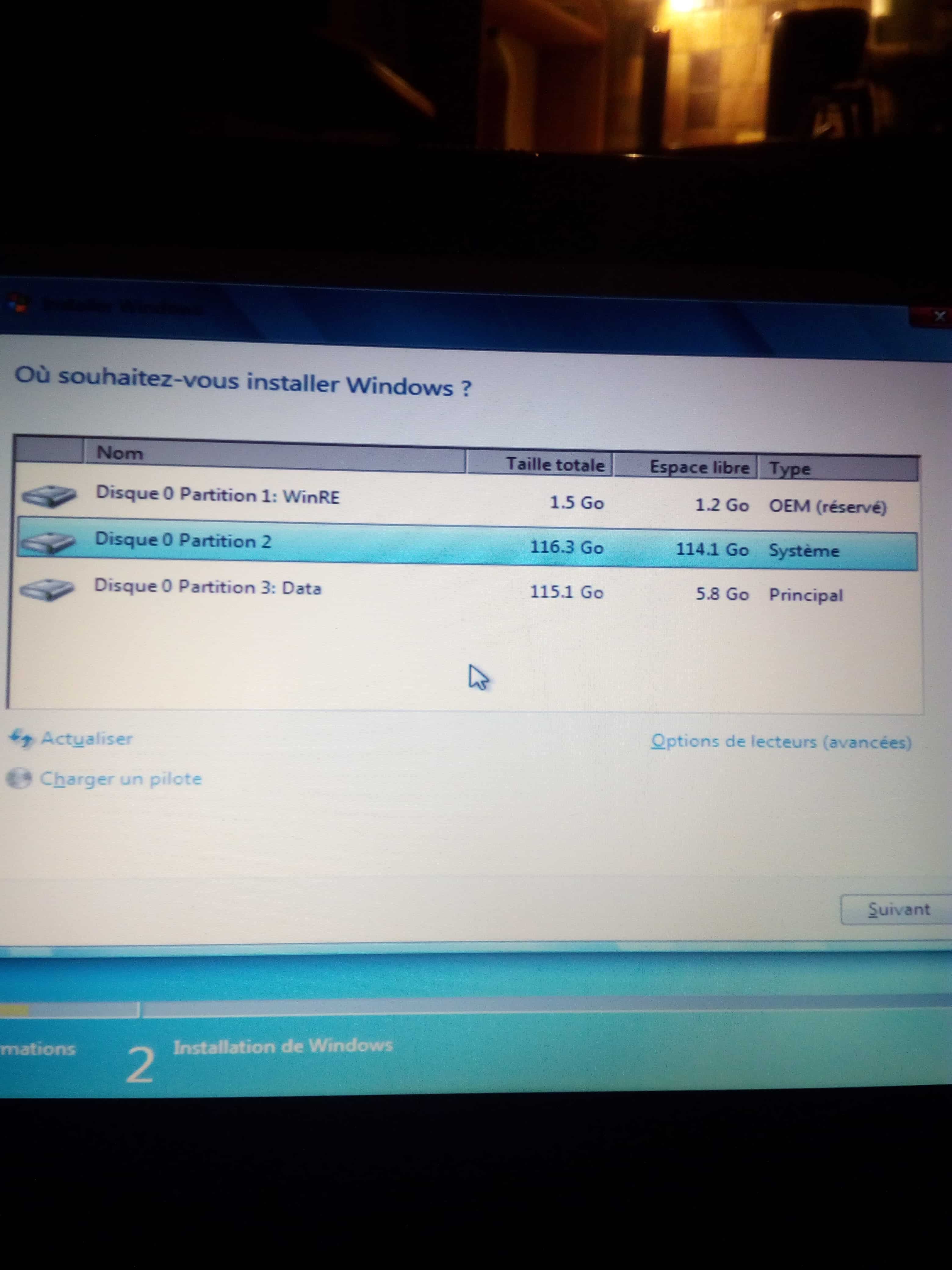

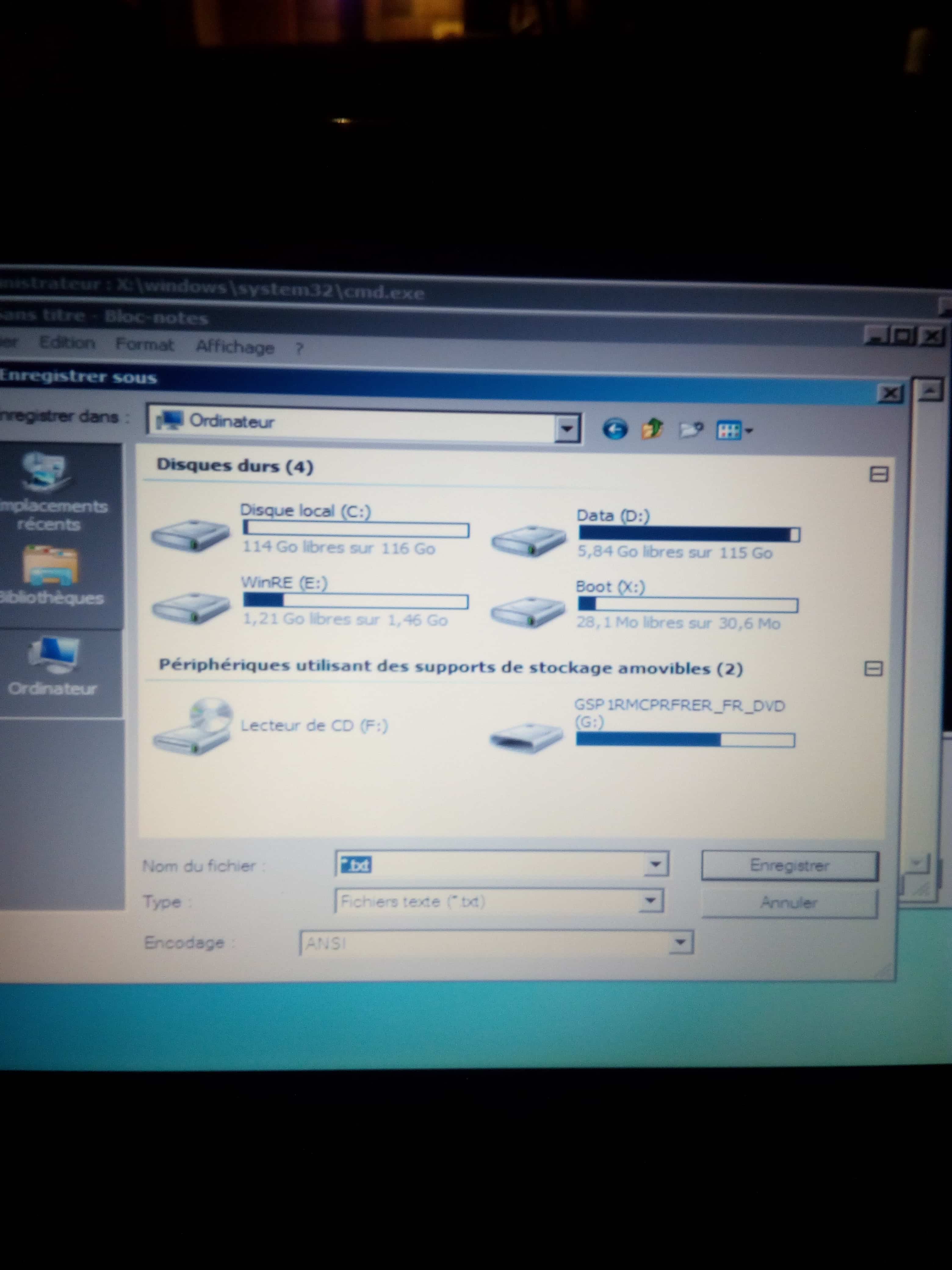

Voici les photos demandés:
Photo 1:
download/file.php?mode=view&id=6830
Photo 2:
download/file.php?mode=view&id=6831
